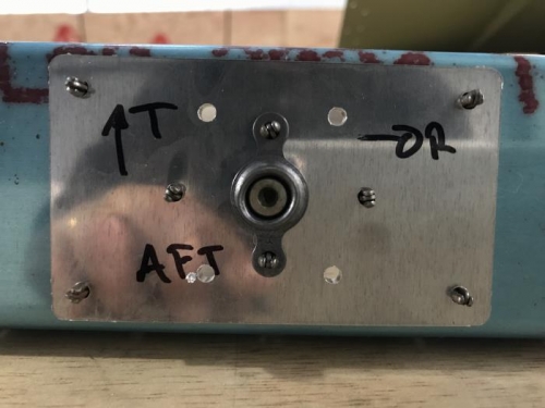

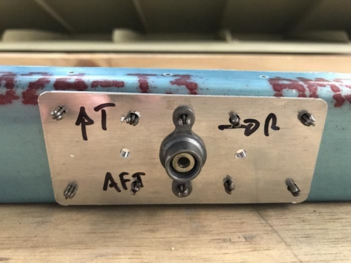

SB 14-02-05 - Elevator Hinge Doublers
Separate the E-00001A & B hinge doublers.
Use a file to radius the top and bottom edges of the E-00001A outboard hinge doubler to nest against the spar radii.
Cleco and drill the E-610PP and E-611PP reinforcement plates, E-00001A & B hinge doublers and
corresponding platenuts to the E-702 spar.
This step covers SERVICE BULLETIN 14-02-05 - Cracking in elevator spar web near elevator attach points.
E-702 Spar
E-610-PP and E-00001A
E-611-PP and E-00001B
