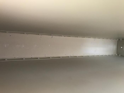

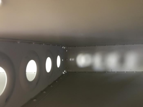

Brief Description:  Vertical Stabiliser - Rivet Skin
Rivet VS-704, VS-705, VS-706 and VS-707 ribs to the front spar.
- Cleco on the VS-801PP / VS-901 skin.
- Rivet on the skin. Begin at the intersection of VS-707 and VS-702 and work towards the tip, then restart at the same place and rivet along the front spar toward the root and along the VS-707 rib starting at the front and riveting toward the rear spar.
- Cleco on the rear spar assembly and install the remaining rivets along the rear spar and end ribs with a squeezer.
- Blind rivet the rear spar assembly to VS-707.
