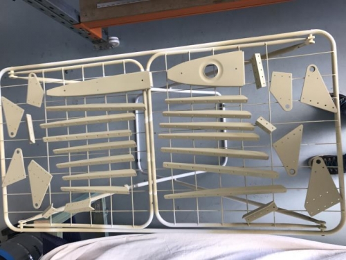

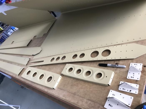

Brief Description:  Vertical Stabiliser - Prepare and Prime
Mark the location and orientation of VS-803PP, VS-411PP and VS-412PP. Disassemble, de-burr, dimple, machine countersink and prime parts as desired (See “Countersinking”, “Dimpling”, “Hole Deburring” and “Priming”, Section 5.1, 5.2, & 5.5).
I spent alot of time preparing these parts for priming. I think they have come up nicely. Used scotchbrite on a disc wiht a die grinder for the large surface areas.
