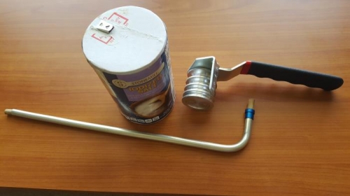

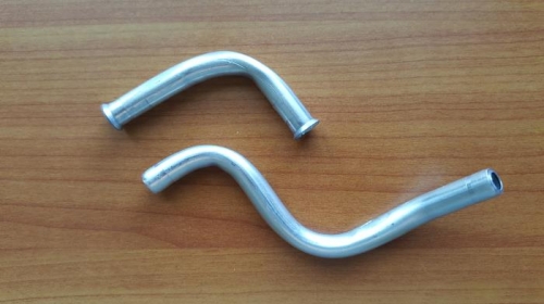

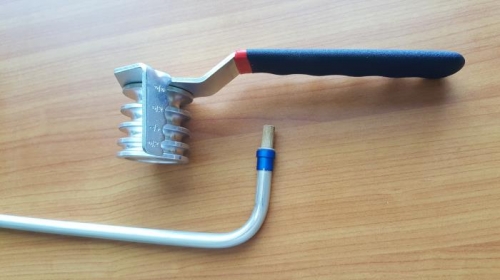

Working with fuel lines. To be able to do a tight bend radius on the aluminum fuel lines I used a regular salt. Same results could be achieved with sand, but salt if it stuck inside of tubing could be dissolved by water, but you can’t do that with stuck sand.
