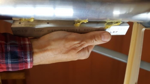

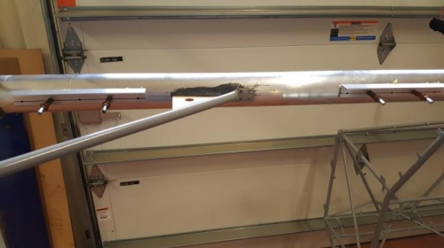

Working on mount brackets for fuel tanks installation. I clamped sheet of plywood to the bottom of the spar tubes, clamped brackets to fuel tanks, put tanks on plywood and temporary glued brackets to spars with Gorilla glue. Next morning I removed fuel tanks and drilled rivet holes in mount brackets. Then I brock out brackets from spars and cleaned glue (Gorilla glue is very easy to remove).
