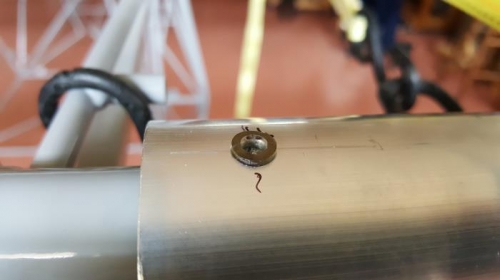

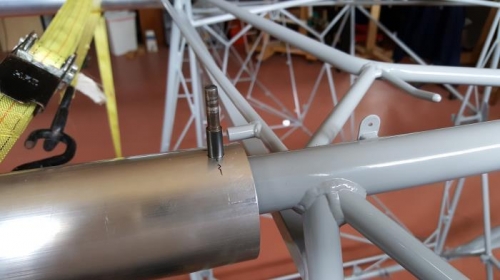

Setting wings to fuselage.
Finishing setting wings to fuselage. I used the vinyl tubing as drill bit guide to drill pilot holes. For final drilling (still undersize for later riming) I made the drill bit with short spiral so it will not enlarge the top hole in the spar.
