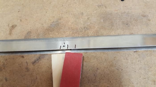

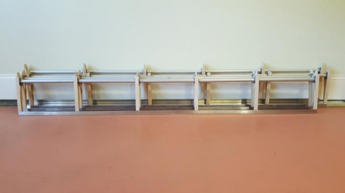

Gluing ailerons and flaps trailing edges. To abrade the inside of the trailing edge I used the 1" sanding belt and piece of thin plywood. After cleaning with acetone I applied glue and rivited trailing edges to ribs caps.
