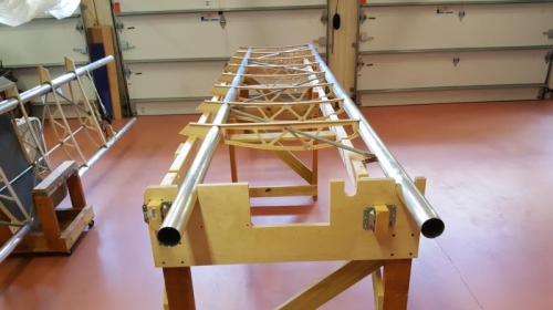

Right wing preassembling. Fiting drag/antidrag braces. Aluminum parts cleaning.

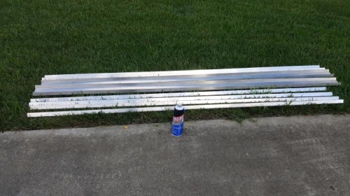

Aluminum trailing edges were very oily and it was difficult to clean them with acetone and I used the engine degreaser from Wal-Mart and it worked out wery well.
