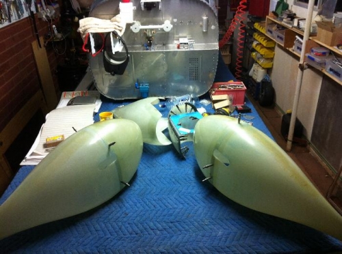

Brief Description:  Main wheel spats
Main Wheel Spats ready to add the epoxy seating for the wheel bracket locatings on each at last.
Much very patient cutting and sanding to get the result.
Interestingly the spring cut out measurements were approx 1/8" too low so spring was not center in cutout and rubbing on the upper edge. Doesn't matter in this cae as we have intersection fairings to fit which will hide the gap anyhow.
Fairngs with cutouts and holes all drilled

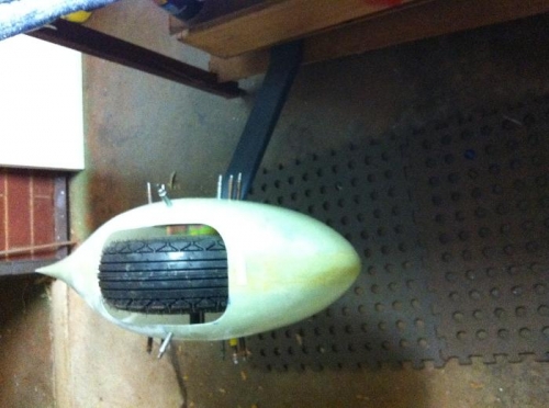

Fairing fitted to main whel and spring assy. Rear view.
Fairing fitted to main whel and spring assy. Front view.
