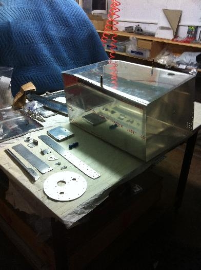

Brief Description:  Fuel tank preparation for assembly.
Cut hole in tank lid for Mechanical fuel guage.
Drill off guage mount holes and doubler plate holes.
Drill off aux fuel fittings in the front access and guage sender mount plate.
Scuff all surfaces ready for assembly.

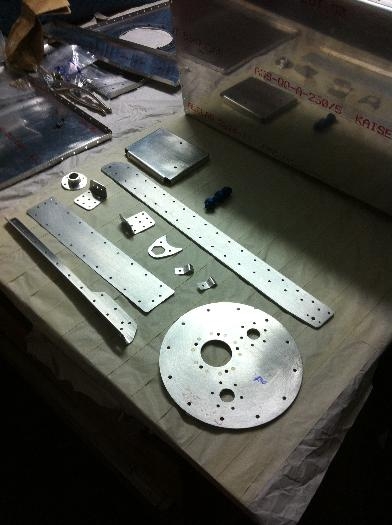

Parts ready for assembly
Anti rotation bracket and brackets drilled off for assembly.
