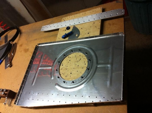

Brief Description:  Fit doubler ring to front wall of fuel tank.
Dimple and countersink as required and rivet ring into place.
Cleco front mount plate to tank and drill of bracket support clips.
Countersink front mount bracket lower row of rivet holes.
Mark out fuel guage mount plate (and tank internal access cover) for extra fuel fittings for auxillary tank plumbing. Also mark out return pipe fitting anti rotation bracket.
