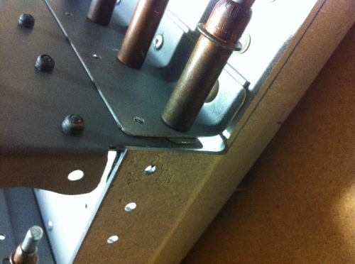

Make up shim (From 2 of the trimmed rib flangesto pack out inboard rib correctly to aleviate deformation when riveting lower row of rivets.
LH inboard rib shim
LH inboard rib shim
Shim fitted (held with cleco 's

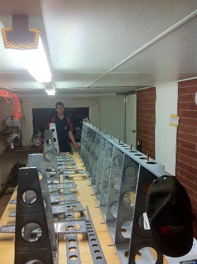

Left wing rear ribs and spar cleco'd.
