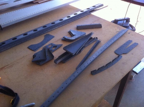

Continue preparation of wing ribs.
Assemble front and rear spars. (Front spar 120Deg countersinks still to be done once borrowed cutter arrives.

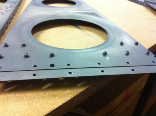

Noticed problem discusswd in several builder comment re deformation when riceting front flange of inboard rib. (shim made next day and added.)

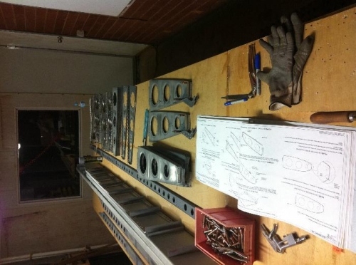

Primed components ready for assembly
Ribs & more ribs!
Ribs & more ribs!
Step in metal thickness at attachment face.
