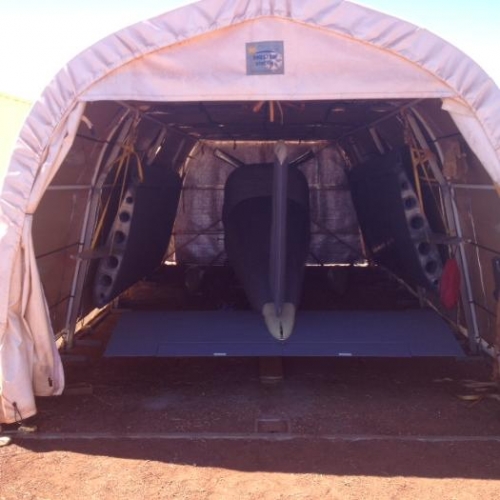

Brief Description:  RV 12 personal hangar
Shelter Station hangar used for our skyfox prior to the RV12 being cmpleted.
The structure is a modified LEGrand model "Shelter Station" product.
- The Structure has the following modifications to make it suitable for use here in the North West.
- A 50 x 25mm RHS doubler fame inside of each of the bows
- Utilises the earth augers supplied with the shelter as well as dyna bolted to a concrete slab that was 3/4 of the length of the shed.
- 1/8" cable bracing in the wall bays and the roof bays
- Aircell insulation lined to reduce the heat inside the shelter to ambient temp
- 5 X 750Kg Ratchet strap bracing across each end to give extra support as well as support for the end flaps (Doors)
All tucked away.

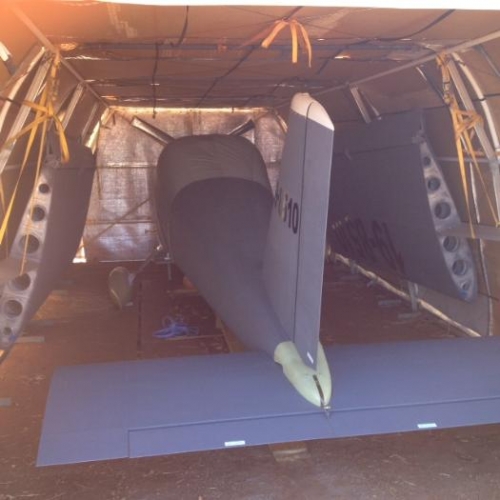

All tucked away.
Nose wheel ramp to lower tail
