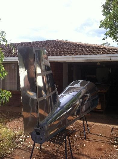

Brief Description: Tailcone front most former rework
Remove rivets from sidewalls of forward most bulkhead to rectify sidewall distortion. Side walls shimmed out with .045" of packing strips to remove deformation and oilcanning. Trial fit of fin and rudder, as well as trim rudder stop for correct mating on the stops.
** Fin and rudder removed for final fitting later due to storage space constraints. **
