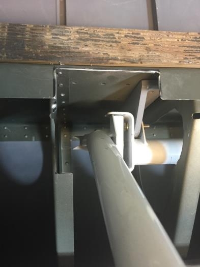

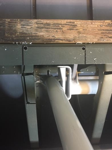

Cut out spar web for control clearance!
Marked by movement to the stops!
Drilled corners!
Dremel and scotchbrite wheel once cut!
