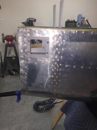

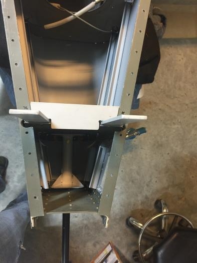

Brief Description:  Last Bulkhead Riveted in!
Oh it's UGLY looking but it's strong and will do the job. Finished the tail dragger conversion and moving the aft two bulkheads 1/2 inch fwd. As the horizontal stab would not reach the fwd attach points. Lots of extra rivets in there and only had to use about 6 blind rivets due to the tail wheel bracket.
