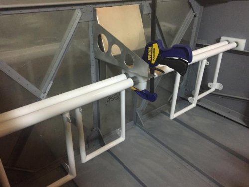

Brief Description:  Fabricated center bracket and test fit rudder peda

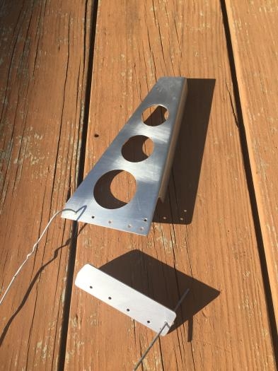

Had to make a spacer to go between the firewall recess and the center bracket for the rudder pedals. There was not going to be enough space for solid rivets or even blind rivets between the vertical firewall striger and the recess. So I made a spacer to take up the gap and I can now rivet thru the recess, bracket, spacer and vertical stringer. Should be extremely solid!
Spacer Fabricated
Spacer Fabricated

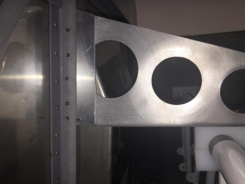

Drilled and ready for prime and paint!
All fits nicely!
All fits nicely!
