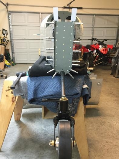

Brief Description:  Tail Wheel Modification!
Had to have a machine shop cutoff the end of the stock tail spring and mill the end smaller to fit in the JD Air tail wheel assembly. They also drilled the attach bolt holes as it is hardened steal. Now I can finish prepping, and painting to do the final riveting.
