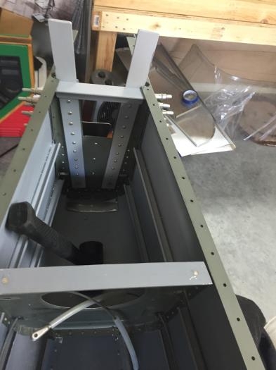

So this tailwheel conversion has taken a lot of time as I want to get it right! I found that the original builder that stat=rted the Fuse Kit had mounted the aft two bulkheads 1/2 inch too far aft. I removed them both and scrapped them. I built two new bulkheads and have been test fitting them. I had to fabricate two aluminum strips to close the old holes in the fuse and then drill new ones in the proper position. I have drilled the b=new hole and will remove deber and rivet in the aluminum strips to close the old holes.
Old Bulkheads out and tail cleaned up!

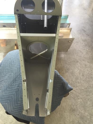

Test fit of F-711
Test fit of F-711

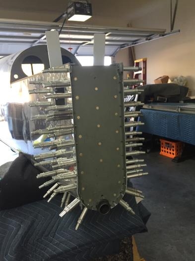

Test fit of F-712
Test fit of F-712
