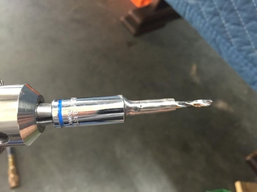

Brief Description:  Fabricated Drill Guide, Drilled Elevator Horns to
I purchased a 4mm tappered socket from Lowes in hopes it would fit into the 1/4" pivot bearing for the elevator's. Needless to say I had to shave a good amount of material off to attaing 1/4" and a good snug fit in the bearing. This allowed me to protect the bearing while drilling the pilot holes in the horns. Then I removed them and drilled to the final size of 1/4". They all lined up well when installed on the plane with no binding and smooth movement.
4mm Socket Modified to fit in bearing!

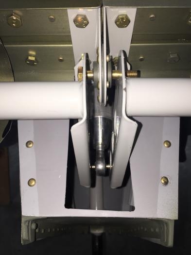

Drilled and bolts test fit!
Test fit on plane!
Test fit on plane!
