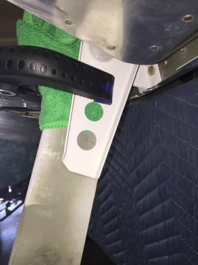

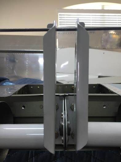

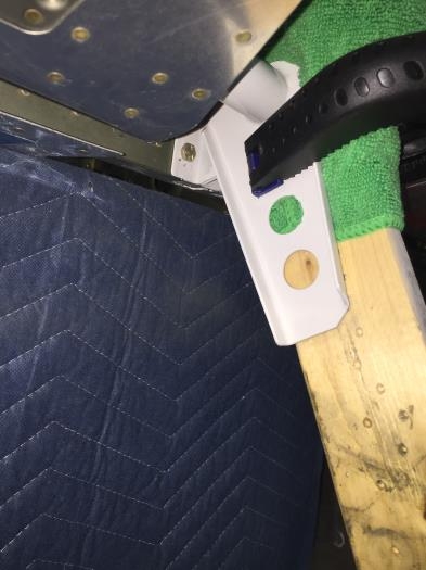

So I adjusted on these Elevators for about an hour and a half trying to get them as closely aligned as possible. I had them on and off what felt like 100 times but was finallt able to get them almost perfect by adjusting the rod end bearings.
Left Horn Clamped to the Right
Right Clamped to the Left
Alignment!
