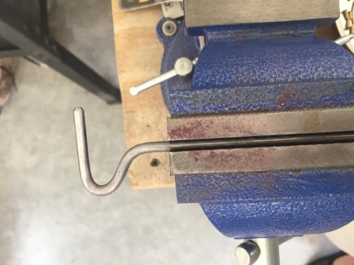

Brief Description:  Manufactured some hinge point pins for the Rod End
Fabricated six of these to use to attach the rod ends on the elevators and the rudder as it is taxing using bolts. They are so hard to get in and out while test fitting everything these will save hours of frustration!
1/4
1/4" Steel Round Stock
Polished end and then bend

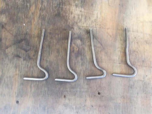

4 of the six, last one is the first one I made.
