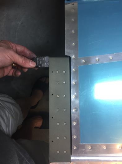

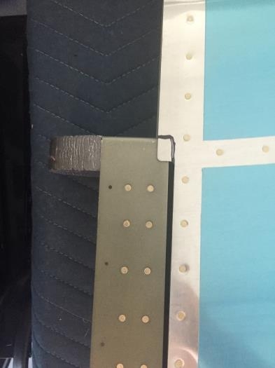

Brief Description:  Adjustments for the Elevator Travel!
Had to make some adjustments and trim the Horizontal Stab Skin to fit the Elevators for up and down travel. Also had to cut a notch into the aft horizontal stab spar for the down travel. Looking at ofther builders logs this is common as the manual says it may need to be done!
Marked the skin whin needed to be removed!

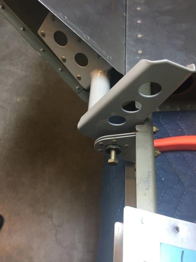

Notch cut and smoothed with scotchbrite wheel
Notch in Horizontal Stab aft Spar!
