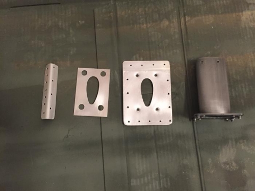

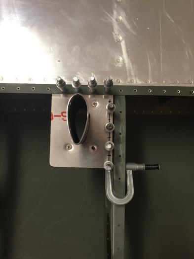

Date:  12-27-2015
Number of Hours:  1.50
Brief Description:  Pitot Installation
Ended up deciding to place the Pitot tube the next outboard bay from the access panel. This will allow a good margin of clearance from the wing tiedown so as not to worry about the tiedown chain /rope from rubbing on the pitot tube. I think I will still have plenty of access to it through the lightining hole. Also had to fabricate the angle brace to attack the mounting platr to the rib.
