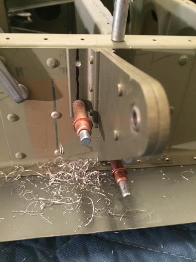

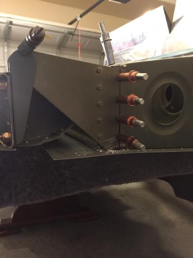

Brief Description:  Started installing flight controles on LW
Had to first cut off the outboard end of the rear spar flush with the end rib. Cleaned that up with some scotchbrite and then clamped the brackets in place after taking about a 1/4 inch of material off the upper edge of both brackets. Then was able to line everything up in order to drill the brackets to the rear spar.
Outboard ens of rear spar aileron bracket
Inboard aileron bracket

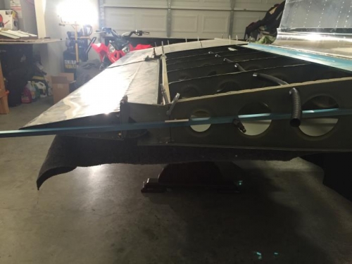

Straight edge with tooling holes in main rib
