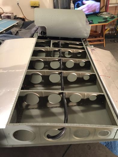

Closed RW lower outboard skin!

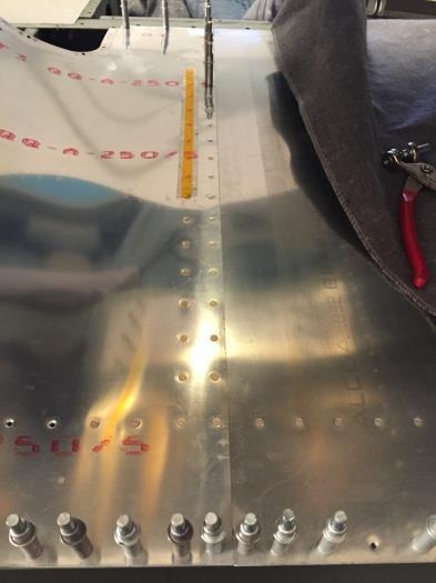

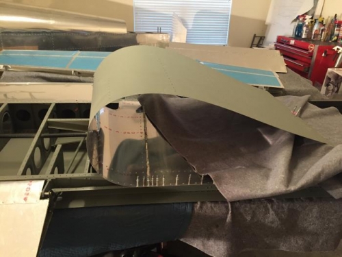

Again I used the same technique riveting the aft spar first working up the ribs the across the main spar. This allowed me to rivet the entire skin myself without having to contort too much!
Started with the skin rolled up at the inboard end
Riveting the skin overlap first
Working from aft spar up the ribs
