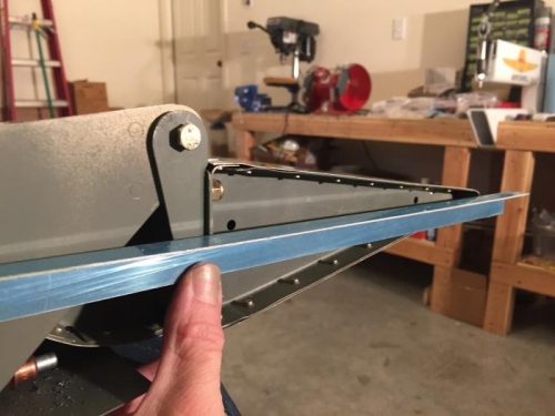

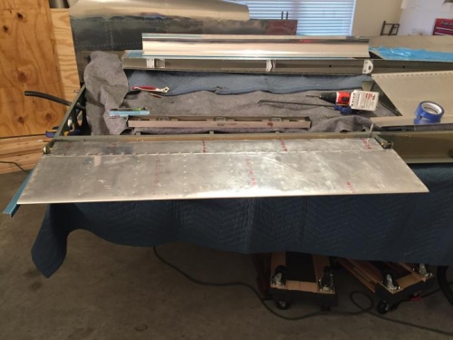

Took a while to get all the alignments sorted out using clamps and an asortment of sponges and towls to adjust the proper gap, hieght and alignment by my self. Finally got everything aligned and drilled. Used AN 3 bolts to secure it with a shim of aluminum tubing on the inboard bracket.
Using long straight edge alinged with manufactured holes to align trailing edge!
Appears to be in trail and adjusted properly.
RW Aileron installed
