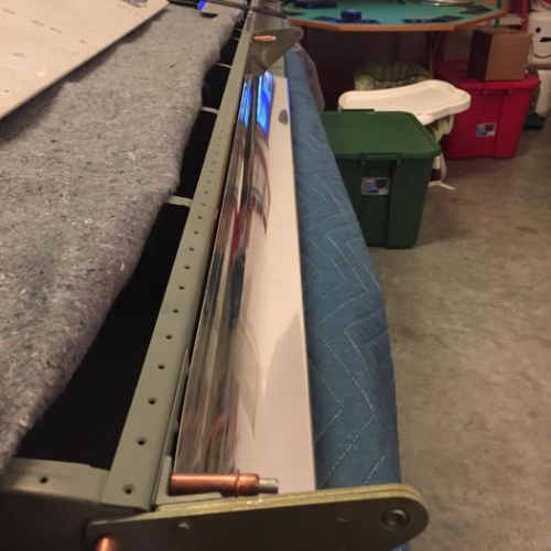

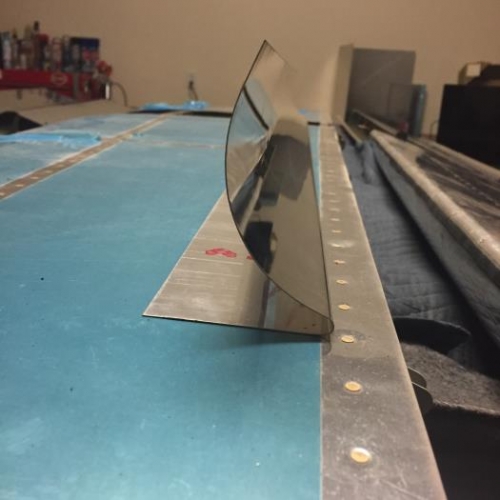

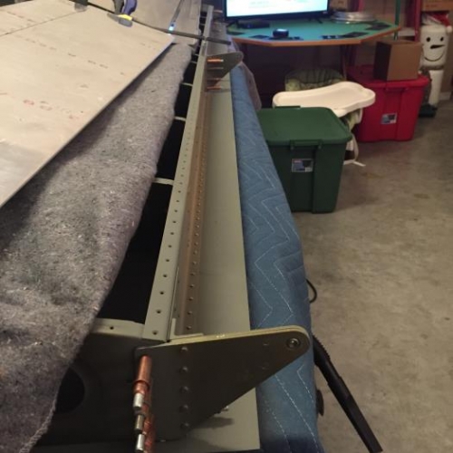

Finished cleaning up the right wing aileron attach brackets and started to fit the aileron gap seal. Issue I ran into is I have already riveted the upper wing skin to the aft spar which should have had the gag seal under the skin. So I can either drill out 46 rivets along the trailing edge or cut the gap seal to fit and just rivet it behind the aft spar. I have a third option looking at an RV-7 build they use a different gap seal which looks just like the flap attach bracket and does not get riveted inder the skin. So I could order these from Van's as they will work better I think.
Sanded and primed both ai;eron attach brackets
Aileron Gap Seal profile view.
Gap seal in place however not fitting properly as stated above!
