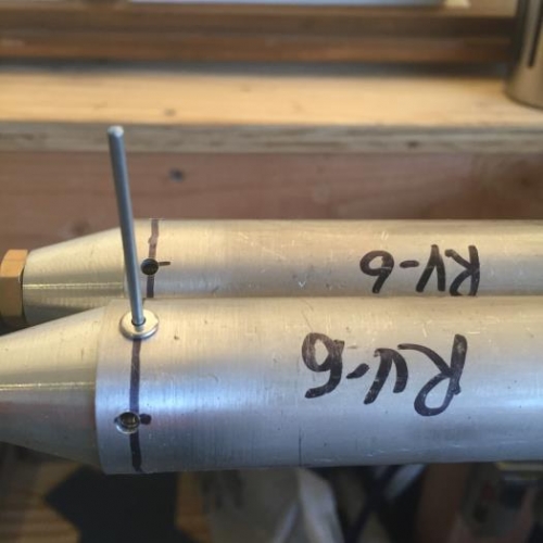

Brief Description:  Riveted the ends in the Aileron Push/Pull Tubes

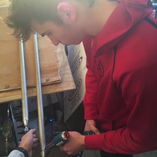

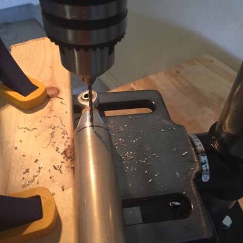

Each Tube end is pressed in and then secured with six LP4-3 Bilind Rivets. Used the new drill press to align the holes properly. Justin was nice enough to come out and help pull some rivets.
Used the new drill press and a guide to ensure the holes were true!
LP4-3 Blind Rivets x6 each
Some Blind Rivet Help from the Boy!
