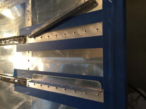

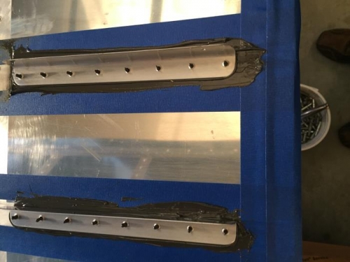

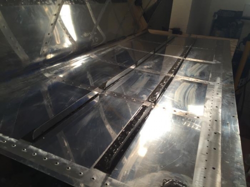

Stiffeners prepped, cleaned with MEK as well as all mounting surfaces and rivets. Riveted in place and will wait for the Proseal to set-up and start the tank assembly in the next round.
