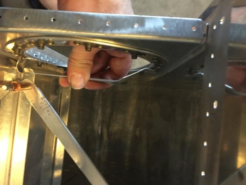

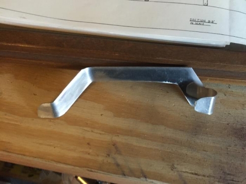

Spent a couple hours working on the right wing fuel tank today. Got the tank stiffeners cut shaped, drilled, deberred and dimpled. Worked on fabricating the inverted fuel pick-up guides to ensure it doesnt get hung up on anything. Almost ready to get back to assembly on the right tank with the Pro-Seal and rivet it together. Getting close to being able to do the final assembly on both tanks.
Built fuel tank pick-up guide!

Inverted modification to RW tank
Both temp held in place
