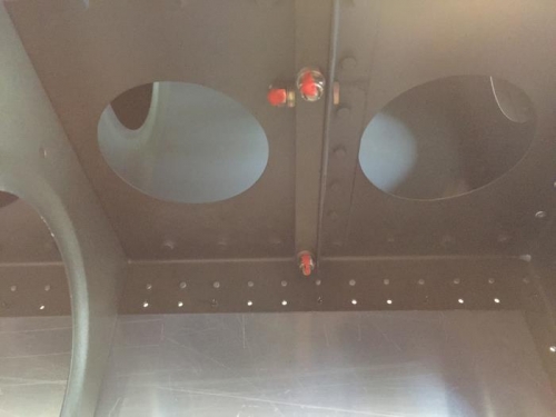

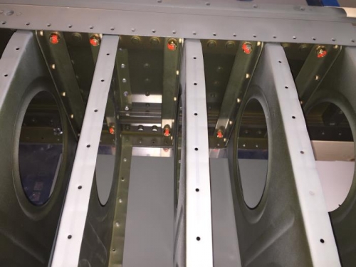

Brief Description:  Wing Bolts Torqued and Striped
Bought a crappy torque wrench from Harbor Frieght that was a mistake! I now have a better one from Sears but should get a good one from Snap-on or someplace more likely to have a quality tool. Anyway all the nuts are torqued to spec and torque strip applied to allow inspections to determine if any have moved over time.
Torqued to 25 inch lbs
Torque strip applied
