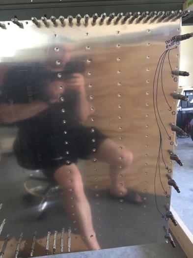

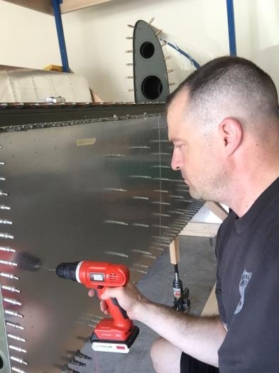

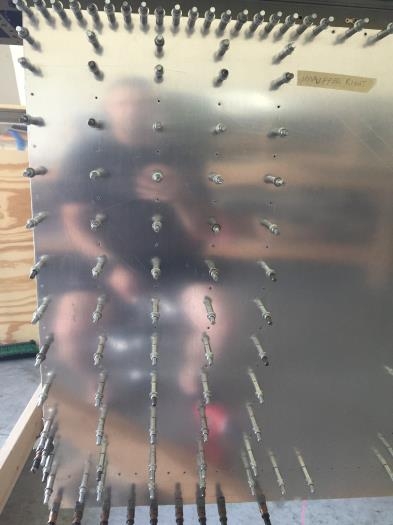

Match drilled both wing walk areas with the doubler skins. 13" by 27.5" they were flush with the training edge and ended prior to the top row of holes that attach to the main spar. This allows the wing skin to lay flat without buldging from the additional thinkness against the main spar.
Held in place with clamps!
100+ holes in each!
100+ holes in each!
Clecoed as I drilled for rib alignment!
