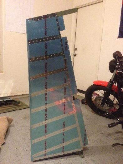

Brief Description:  Final riveting of the rudder/Rolling the leading e
The rudder skin was riveted to the understructure and MK-319-BS blind rivets were used in the last few trailing edge rivet holes. The leading ege of the rudder was then rolled/formed and blind rivets were used to rivet the rolled edges together. Rudder is DONE!
Completed rudder
Completed rudder
