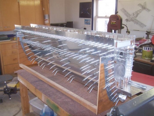

Today I Finished getting everything pre-fitted and deburred for sealant in 2 days (going to Dodge City to have Mike Million help). Made the plates to cover the tooling holes in the end ribs, fitted and deburred the VA-141 Finger Strainer Flange, T-1010 anti-rotation plate, and nutplates to the T-1003B-R rib (doing right tank first). Basically just read through the rest of the instructions and set out all the parts needed to complete the rest of the tank construction.
Strainer flange, nutplates and anti-rotation bracket clecoed on.

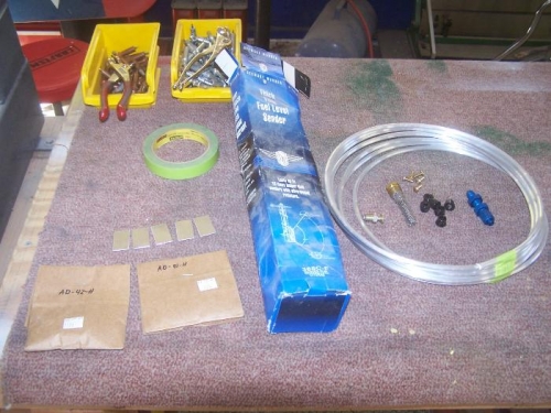

Rest of parts to take along to finish. Fuel level sender, vent tubing, rivets, cover plates, etc...

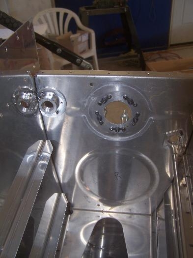

Ready for sealant!!!
