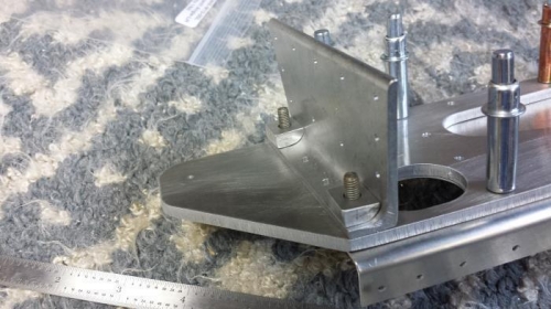

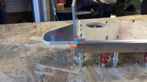

Unfortunately, the left spar channel that was laser cut and pilot drilled was drilled in the wrong place. You can see in the picture below. The good news is that Sonex is sending me a new piece at no charge.

Left Angle and Channel not flush
