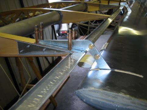

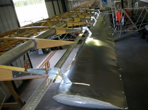

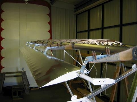

Brief Description:  Flaperon bracket installaition.
Reamed holes in brackets and flaperon mounting tabs to .1875 dia. assembled brackets onto flaperon as shown in Fig T-1. Temporarily securing flaperon brackets to wing using strapping tape. Adjusted position of brackets and drilled holes into ribs from pilots. Three of the trailing edge holes on each wing will be drilled up after installation of fuel tanks.
