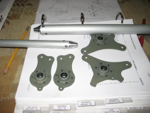

Brief Description:  Bellcranks and push rods

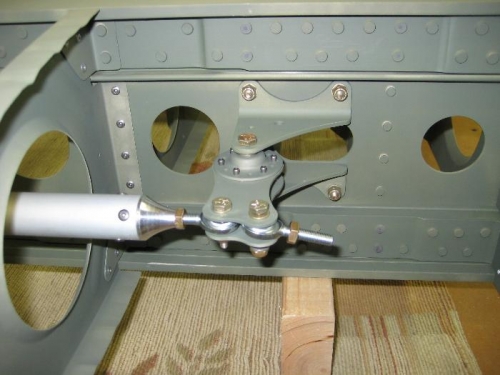

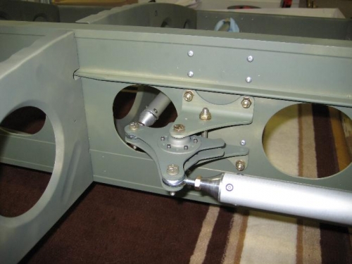

Drilled, deburred, polished edges,and primed bellcranks and bearing housings. Riveted bearing housing and bearings to bellcrank halves. Fabricated spacers for rod ends and bellcranks. Riveted adapters into four push pull tubes. Built up right wing inner and outer bellcranks. Had to add one thin washer to the outer and two thick washers to the inner bellcrank. Installed push pull tubes on right wing. Couldn't find the wire for the alignment pins but two #30 drills work fine. Book calls for CCPQ41 rivets on the bearing housing but after measuring I used CCPQ43.
Bellcranks and push tubes
Outboard bellcrank
Outboard bellcrank
inboard bellcrank
inboard bellcrank
