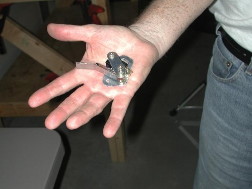

Image 1 shows the Stall Warning device assembled. Looking at the metal piece projecting to between my thumb and first finger is a small, bent tab. The air pushing up from below over the front of the wing causes this piece of metal to rise. That trips a very small microswitch to prudece a small electrical sharge that is carried through an 18 guage wire to the fuselage where a warning is sounded. That alerts the pilot that a stall is eminant and requires lowering the angle of the wings (and usually applying engine power) to avoid sudden altitude loss.

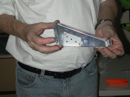

To finish up here will require mounting this to a rib, attaching the appropriate wires, and attaching a terminal at the inward end of the wing. The terminal is shown in Image 2 surrounded by an aluminum attachment.
