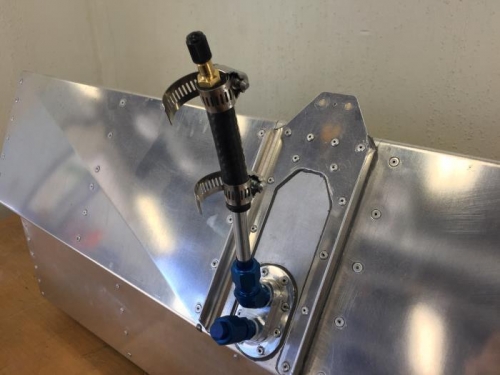

01/02/19: 2Hrs
1. FLF-00017 on the tank was capped using the hardware provided in the fuel tank test kit.
2. A 3/8 piece of tube was trimmed and flared, then the hardware shown on figure 1 was attached.
3. A condom with a rubber band was used to create an air-tight reference.
4. The tank was filled with air using a pump until the condom inflated and the former was then sprayed with soapy water to check for any leaks, even so, tomorrow it will need to be checked again at the same temperature to confirm that the condom is still inflated.
