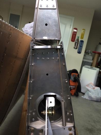

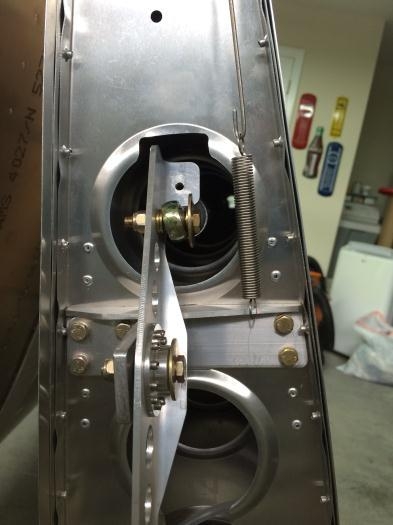

Fab and installed flap reinforcement tab. I installed my spring a little different than SPA. Didn't see were the spring tab was needed.
See picture #2 just drilled a 3/32 hole for spring to attach.
Picture #3 show flap return spring completed with flap stop screw installed.
