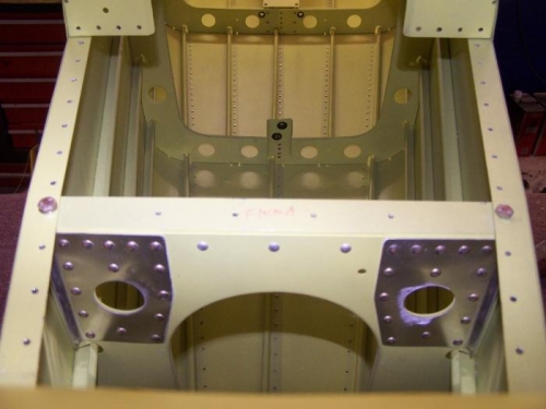

Over the last couple days I finished up the SB on the F-1010 bulkhead doublers. Included deburring, priming, riveting on and then riveting the F-1014 aft deck back down. Did not use the typical Sherwin Williams epoxy primer I've used on the rest of the plane so far because this was so small. Instead I used Dupli-color primer from wal-mart and painted over it with a yellow rustoleum (yellow is much different than the rest of the plane but oh-well).
Doublers riveted into place

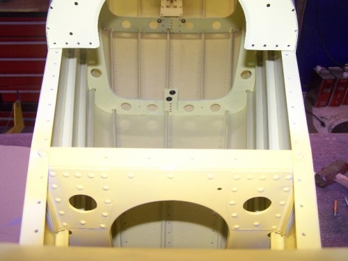

Front view of the F-1010 bulkhead.  (Doublers are on the other side).

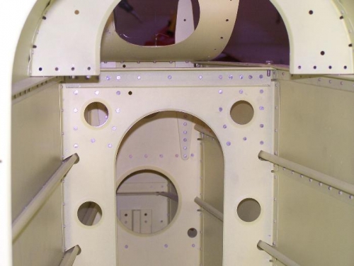

All finished and primed.  Notice the gray primer and the nasty yellow rustoleum overspray.
