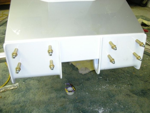

Rear skid mounts were drilled and clecoed to the body so that dimensions could be taken for the shims.

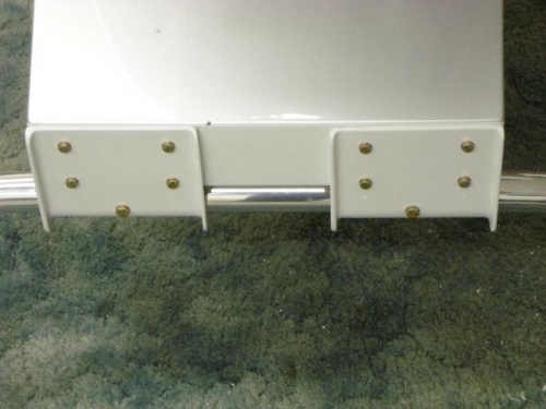

After the shims were cut to the proper dimension bolts were added and torqued. The plans call for rivets but I wanted to be able to remove the gear if nessary.
Rear landing skid mounts.
Bolts added.
Bolts added.
