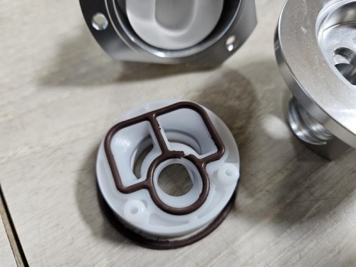

Brief Description:  SPRL Fuel Valve Seal Flaw
During the fuel flow test we discovered the fuel still came out a little bit, even with the selector being off. I took the selector apart and found the seal at the bottom of the stationary ceramic portion to have a defect. I contacted SPRL and they will provide a replacement at no cost!
