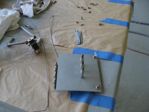

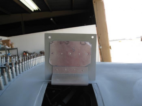

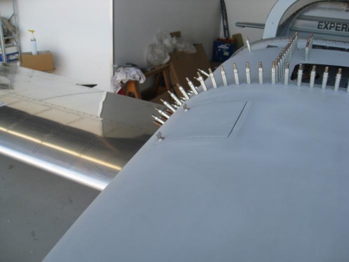

Brief Description:  Added Stifferner plate to oil door
When the spring is installed on the oil door it tends to make the door bulge and not sit flush with the top cowl. The door needed to be flatened some so I fabricated and riveted an aluminumn plate to the bottom of the oil door. Worked fine.
Oil door stifferner being assembled
Stifferner on oil door
Oil door now sits flush.
