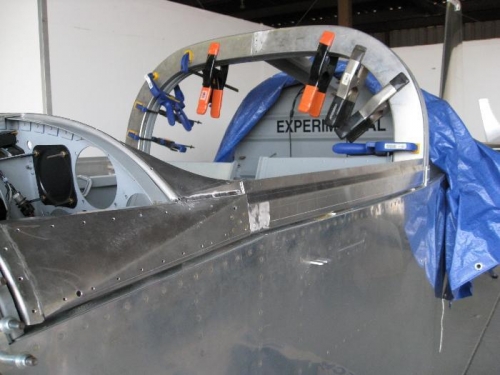

Brief Description:  Drilling the F-631 to the WD-725 side rails
Riveted the side rails to the canopy frame via the C-613 splice plates. I aligned the F-631 channels to the roll bar and the side rails so I could drill the channels to the side rails near the aft of the assembly.
Drilling F-631 to the WD-725
