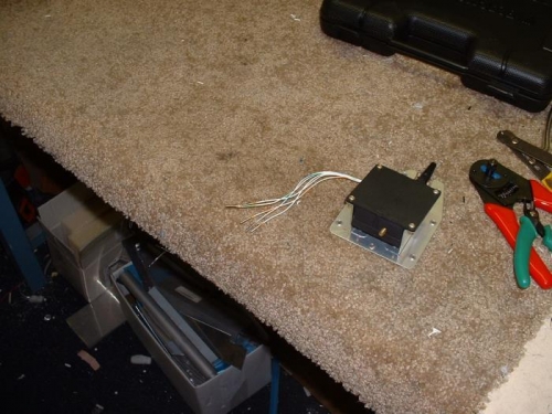

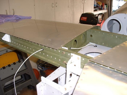

I removed the vertical stabilizer today since it was difficult to access the inside of the tail with it attached. I spent a considerable amount of time trying to figure out how to run the multi-conductor wire to the trim servo. I wanted to make sure that the wire would not interfere with the control tube so I installed that also. I drilled a hole in the deck where the horizontal stabilizer rests and installed a snap bushing. I then drilled a small hole in the rib of the stabilizer, installed a rubber grommet, and then ran the wire out through that hole and then through the hole that is adjacent to the trim servo.
I also crimped D-sub pins to the wires of the trim servo. I will have to order some more of the pins as I am almost out. I cut the passenger stick down by 5 inches to match the pilot control stick. Doesn’t seem like much for 4 hours but unless there are clear-cut instructions, I move pretty slowly when it comes to wiring.
Trim servo with D-subs
Trim wire routing.
Trim wire routing.
