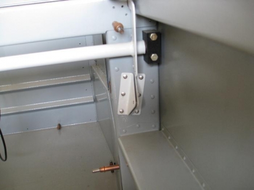

Brief Description:  VS-411PP installation.
I finally riveted the VS-411PP after many years of just being cleco'd. I had to ream the holes with my #30 drill to clear out some of the urethane that found its way into the holes which kept the rivets from installing. I used my rivet gun and bucking bar as I could not get enough leverage using my squeezer from outside of the plane.
VS-411PP
VS-411PP
