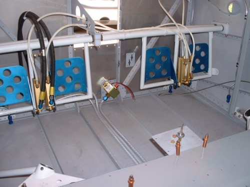

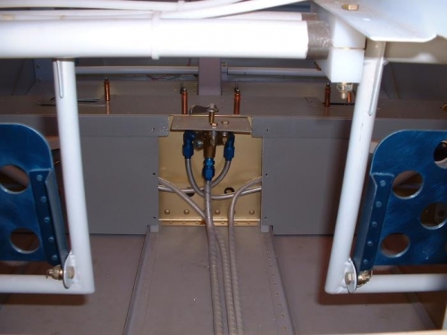

Today I worked 9 hours on what should have been 6 at the most. I started out using some RTV that I procured last week from Aircraft Spruce to seal the air vents. I oozed a layer around the perimeter of the plastic vent and cleco’d them into position. I waited for the RTV to dry and then I riveted the small NAS rivets with the aluminum backing I had made previous. The vent job worked out nicely. I then decided to make the fuel line that goes from the fuel selector valve to the backup electric fuel pump. I had trouble months ago making this piece because of the tight bend near the pump and the floor on the plane. I am still not sure if I have this flaring business down but I did my best. Had to unscrew the lines from the wings to the fuel selector valve, which caused me a problem as one on the fittings pulled loose. I had to trim and flare that fitting in close quarters as I lay in the plane. I did a lot of swearing! I am wondering if I scratched the mating surfaces of the fittings and lines with all the moving and positioning I did? I hope they don’t leak.

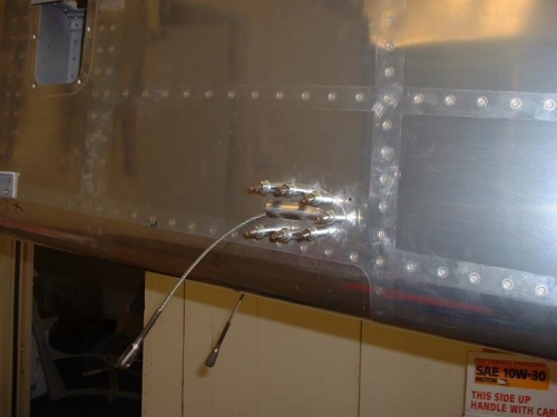

I then worked on making the little farings for the rudder cables. I was way too anal with getting perfect symmetry in both the shape and hole pattern. When I got what I thought was near perfect fairings, I drilled them to the fuselage only to discover that the lower holes are much to close the stringer on the inside of the plane. I will probably have a difficult time riveting those holes if I don’t elect to use pop rivets? I will wait till I dimple for the # 8 screw that holds the plastic tube that protects the rudder cable. I need to figure out how to dimple this. If I had the standard kit I could have dimpled it before the skin was attached to the fuselage. I will probably drill a hole in one of my bucking bars for the # 8 dimple die and go at it from that standpoint? We will see. Almost forgot, I installed the static ports on the side of the fuselage. These are ports that I bought at Aircraft Spruce. Using these instead Van's method of static ports.
Fuel line to pump
Fuel line to pump
Fuel line to pump
Fuel line to pump
Rudder cable fairings.
